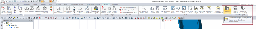

hello friends
how to change the Turkish steel code to American code ?
and how to print the connection design report as like below image?
    113.6 KB · Görüntüleme: 455

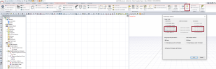

Hello Ammer;
You can change the steel code at the analysis and design tabs. If you change the design code for steel frame, ıt's automatically changed for connections.
    165.4 KB · Görüntüleme: 6
Re: how to change the turkish steel code?
Hi ms nurgul
I upgrades my idecad recently from concert to con steel
I don't find this option
Check image
Dear Ammer;
Please check the pictures.
    89.3 KB · Görüntüleme: 6
    212 KB · Görüntüleme: 445
Many thanks mrs. Nurgul
The issue are solved
I reinstalled the software
